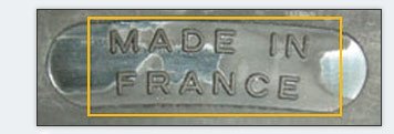

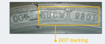

Michelin Tyre recall: Pilot Power 2CT and Pilot Power 120/70 ZR 17 front motorcycle tyres
Michelin has launched a campaign to recall its Pilot Power 2CT and Pilot Power 120/70 ZR 17 front motorcycle tyres with “Made in France” markings. An examination of these tyres showed a possible defect in the tread due to a manufacturing irregularity. No cases of pressure loss have been reported and no accidents have occurred.
Because customer safety is its primary concern, Michelin has decided as a precaution to replace certain 120/70 ZR 17 Michelin Pilot Power 2CT and Michelin Pilot Power front tyres, which can be identified by the following markings on the sidewall:
• a “Made in France” label
• DOT 6UCW 980T or DOT 6UCW 979T
• Pilot Power: week numbers 2704 to 0406 inclusive
• Pilot Power 2CT: week numbers 4505 to 1807 inclusive
These tyres will no longer be sold by dealers.

Bilder på de däck det gäller (pilot power/pilot power 2ct 120/70 ZR17) för mer info kolla deras hemsida...
    27.5 KB · Visningar: 37
    11.7 KB · Visningar: 42
