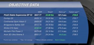

Rykande Färskt däcktest
Sport Motorcycle Tire Shootout Part 1: Introduction - MotoUSA
Sport Motorcycle Tire Shootout Part 2: A-Group - MotoUSA
Sport Motorcycle Tire Shootout Part 3: B-Group - MotoUSA
