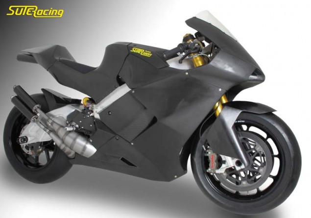

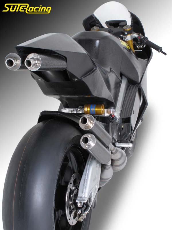

Technical Sports Racing AC28-M Prototype powered by Honda Racing Corporation
Chassis Specifications:
Frame
CNC machined Aluminium twin spar with multi adjustable steering/wheelbase/riding position/height
Swingarm
Aluminium swingarm, CNC machined, adjustable
Suspension
Öhlins upside down front fork & rear shock; all adjustable for pre-load, high & low speed compression & rebound damping.
Different rear links available
Wheel
Marchesini or OZ
17x 3,75 Front
17x 6,5 Rear
Tyres
125/75 R 17 Front
205/75 R 17 Rear
Brakes
Brembo
Two 320mm steel front disc with
4 piston calipers
One 218 mm steel rear disc with
2 piston caliper
Fuel Tank
Carbon Fibre
inbuilt fuel pump
Bodywork
Carbon Fibre
Dry Weight
129kg
(complete, ready to race)

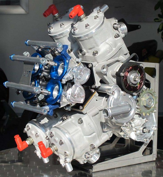

Engine Specifications:
Engine Type
4 Cylinder V4 two stroke
double counter rotating crankshaft, roller bearings
Displacement
54 x 54,5
(56 x 58,5 optional version)
Power
min. 200hp
Aspiration
Electronic fuel injection
four port throttle body
four carbon reed valve
Exhaust Valve
Double flap
electronic controlled
Exhaust
four single resonance steel chambers
(optional Titanium)
Gearbox
SRT six speed cassette gearbox
Clutch
SuterClutch multi disc dry
Ignition
Marelli ECU
K-Man

Vad lång den ser ut :va
Vad är den ämnad för för klass?
Alla 2-takts 500'or måste applåderas ivf :)
